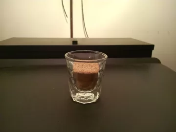

I bought 5 bags Fireside Ultra At HD at $3.94 a bag thinking I would give them a try. I just loaded one bag into my hopper and am tempted to return the other 4 bags. Here is a picture of what was in the bottom of the bag....and this was after I had already thrown away enough that would have finished filling the glass.

That's quite a fine.....;lol Just add water and umbrella and you have yourself a cocktail. Did if feel like all five bags were like that?
I'm not really sure how to tell. But I don't like the way they burn either. The pellets are hopping all over the place in the burn pot and some are even flying out. That's it. The remaining 4 bags are loaded in the car and now see if HD will exchange for MWP.
I used these all last year with great results. If I were you I'd give them another go.
Unfortunately fines are measured by weight not volume. You would need to weight it to see if its considered out of spec. What size glass is that(in ounces)?
Looks like a shot glass. 1 oz.

I was thinking the same thing. A shot glass if fines doesn't seem out of line to me. I would toss those into the burnout and go full that glass with bourbon! I have 4 tons of Ultras in the garage and a Harman that chews through whatever I feed it.
It's also possible that you grabbed a bag that had been handled a lot or dropped, I would guess that would create more fines at the bottom if the bag... Who knows!

The air flow is able to lift the pellets pieces that are pop corning. The pellet piece isn't dense enough to stay in the pot given the combustion air flow you have..
Fines for a premium pellet are not supposed to exceed one half of one percent by weight of the product at the plant gate. Fines increase en-route to you and every time the pellets are handled.
A four ounce glass holds four ounces of liquid water, the fines are less dense than water so a full four oz glass will contain less than 4 oz of fines.
