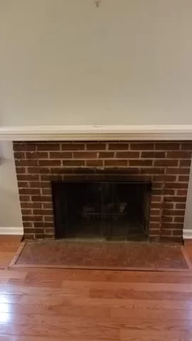

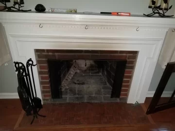

Here is a picture of my open fireplace with the glass doors off. The installer was here today and said that the fireplace surround wasn't safe for any burning. Not sure what to do now.

Did he mean that the mantel wood was too close to the insert to meet clearance requirements? If so there may be other insert options. What is distance from the center of the fireplace to the a) fireplace opening, b) to the mantel trim on the side? And what are the same two measurements vertically?

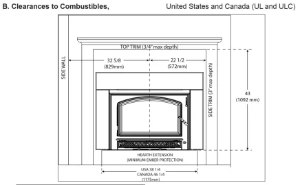

Here is are the voyager grand's clearance reqs. Did he mention mantel shielding?

I think I am OK to the side trim, I measured 44" across. The issue is top clearance to wood trim, it is only 30" and should be 43" if I understand correctly.
No he didn't mention mantel shielding but suggested I hire someone to remove some of the mantel wood but it is 43" to the mantel shelf (forgive me if I don't have the correct terminology but I am learning) but that would essentially remove most of wood I might as well take it all down and who knows what is under it all.
