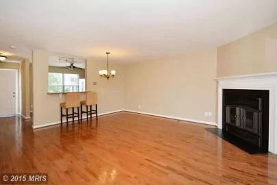

I just bought a new home that was built in 1986. Description says it has a fireplace. I view the home recently (not moved in yet) and tried to determine if it was a fireplace or fireplace insert. I was wondering if any of you could tell me strictly by viewing the picture below. Any help is appreciated. Thanks.
[Hearth.com] Fireplace or Fireplace Insert
Welcome to the forum. I think we would need a better photo, preferably one with the doors open, to give you a definitive answer. It definitely looks like a fireplace, but whether it has some sort of doors on it or whether it has an insert in it is a bit hard to tell for sure. My guess is it is an insert since most doors on fireplaces don't have those big surrounds like your photo is showing. Usually glass doors on a fireplace have the hardware attached inside the firebox and don't include a surround like your photo. You should ask your realtor for clarification. That's what you or the seller is paying them to do. While you are at it go ahead and get them to give you information on the chimney as to whether it has a stainless steel flex liner in it. That is what you would expect if there is an insert in the fireplace. Good luck.
Hard to say from just this picture. It looks a bit like an early zero-clearance fireplace. But it could be a nice door set on a masonry fireplace or perhaps an insert. Another clue might be the backside of this unit. Is this an exterior wall? If it is, what is on the outside, a masonry chimney or a framed-in and wood clad chase?
Thank you both for your input. I figured it would be pretty difficult to nearly impossible to tell just from the picture. I have seen the unit in person and it did have two pretty heavy doors on the front and before I could inspect any further my attention was brought to something else and I forgot to go back and look further. It is an exterior wall but not sure about the chimney situation etc. I have asked my realtor and she is going to get clarification but figured a post on here would possibly prove beneficial. I will be getting an insert if this is infact just a straight fireplace since I've been living every winter burning wood I just enjoy the heat produced from wood much more so than a heat pump which this house has. I have a chimney inspection lined up for next week so I will be sure to get a detailed report of what I'm working with. Thanks again.

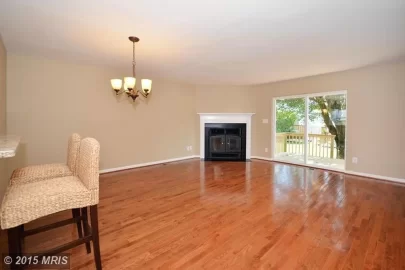

Actually here is a picture facing the front of the unit but this may be zero help whatsoever but it is all I have at this point. Ill take in depth pics soon.

That has a heat exchange system. It looks like an attempt was made to make it semi-efficient. When you get into the house inspect the inside of the door frame for a make and model tag. It might be decent enough to get by for a year.

Hey everyone. I just did the final walk through of my house and got measurements and pictures of my prefab fireplace. I didn't see any model tag and number on the inside. There is a panel in bottom left corner but it's just black maybe the number WAS there lol. Anyway the measurements unofficially are 15 3/4 deep and 29 or so across and 40 x 40in on the outside from door to door and floor to the top of the unit. Let me know any of your ideas or opinions if this is workable for an insert, maybe a pellet stove. It seems it's only letting me load one pic at a time so here's one and I will load more (just the same pic from different angles) once I'm on my laptop. Thanks.
