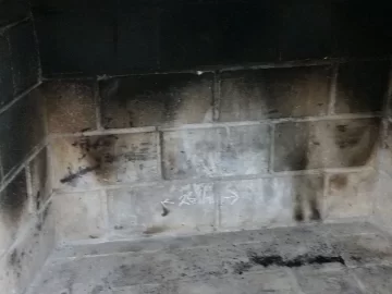

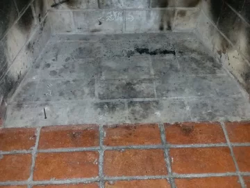

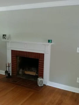

Hi all, I've been lurking here for awhile trying to sift through enough information to make an informed decision on a good wood stove insert or free standing (I'll leave the wood furnace ideas for later) and I just can't seem to work out exactly what I want with what will fit and more importantly what is safe giving my current masonry fireplace. I'm going to try to upload some photos of what I have, any input would be appreciated.
We just bought the house last November so I can say that during a very mild winter we used about 225 gallons of oil per month December to end of February for our heat and hot water needs. House is built in 1960s single pane windows (lots of em) and probably not insulated very well. House has forced air heat/ac and is about 2400 sq ft without the partial basement.

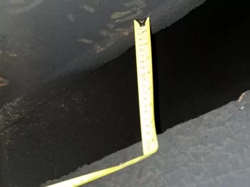

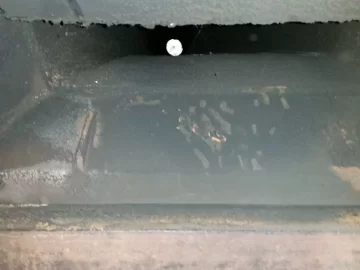

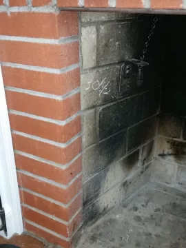

Upon inspection tge fireplace has the metal "top" used in the 60s to avoid the cost of a skilled mason and it goes to a circular chimney pipe. The chimney itself is brick and goes all the way to tge roof, both furnace and fireplace are using the chimney but with 2 differect exhausts. I can't tell the size of the actual fulireplace chimney pipe but it looks like I would be restricted by the choke point where the original damper was. Previous owner cut old damper out and uses a chimney cap that opens and closes with a cord mounted to the left side of the fireplace. Choke point seems to measure about 7 inches or so but it's at an angle so unsure if liner would clear it or not. Front opening 36 rear wall 26.5 sides longest point 21.25 height 30.5.
I really wanted the enviro cabello but fireplace isnt deep enough was going to just go buy the Boston but 3k is alot to spend before you know if it will work lol. Also the chimney brick is not on an exterior wall. Again any help especially with the chimney liner aspect and fitment of the stove would be most appreciated. Oh and house does not have and open floor plan 1960's expanded cape cod 3 bedrooms upstairs. Fireplace is in a "sitting"room in between a larger living room and the main hallway going to the dining room and stairway to 2nd floor.

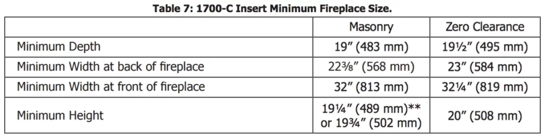

Welcome. The fireplace looks deep enough for the Cabello or Boston 1700. The Venice, Cabello and Boston are all the same firebox, just different front trim. A brick could be knocked out from the smoke shelf to help the insulated liner clear more easily.
