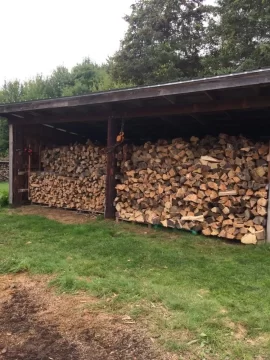

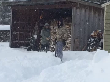

This has moved me to the next level. I think i have $300.00 bucks in it
  • Finally, the stash is dry!  Lesson learned.
That's a beauty. Next couple levels, I think. And, a real feat to get all that done for $300.
I am a hoarder, and scavenger this the low price. But you can build a shed for as little or as much as you’d like. Once you get away from tarps and wet wood you’ll never look back
