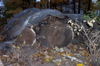

I frequently am dealing with full size mature trees that I have felled, and I have no help during
the splitting and stacking process. My family used to help me, but for various reasons this year
and last I was solo. I wasn't too specific earlier, but I mean rounds so large I have to put a 10ft
ramp on the splitter rail (my splitter's tilt feature needs some work) and roll them on. And
rolling these 150-200lb rounds up the ramp is difficult. In terms of size, I'd say the diameter was
easily 3ft on some of them, and no less than 2.5ft on all of the big rounds.

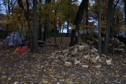

So this is why I elected to get them split to pie slices and not go all the way. The amount of work just to get them that far was a sweating, panting, out-of-breath, and days-end muscles aching job! For several days on end.
I attached some pictures from a few years ago, 2008 I think, of the same kind of work. But last year they were all just very big Bur Oak trunk - no mix.

MikoDel. I see the biggest problem you have. Can't you put that splitter in vertical mode? That save a lot of work. More than can be imagined by most. Even on the smaller logs. I really can see no sense in having to lift each and every lot up onto the splitter. If you look closely at my avatar you'll see how I split wood. I sit while splitting and rarely will I work up a sweat. When the logs are big, I simply roll them and never lift them to get them split.
When big logs do have to be rolled, one simple tool can take about 50% of the work off you. A simple cant hook. I'd really be lost without one.
Second on the cant hook. I was rolling 20' logs with relative ease this past year. Made the work so much more enjoyable. As for the verticle splitting, all I can say is here we go again!
