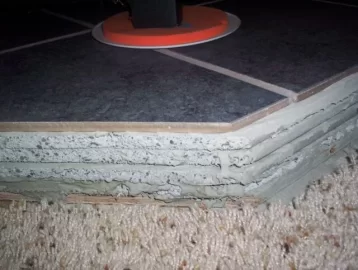

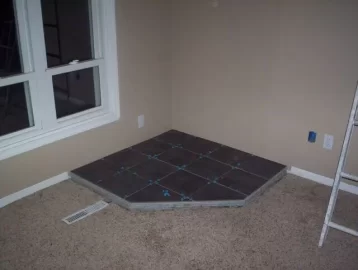

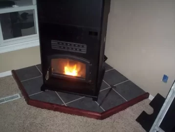

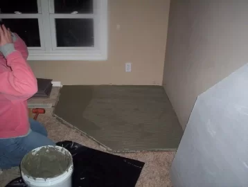

Anyway, here are some details. We built the hearth pad ourselves - cut the carpet and relocated the vent in the floor. Put down a piece of 1/2" plywood, and 4 layers of Durock on top of that set in place with thinset mortar. Total R value should be at least 1.4 (1.0 required by Breckwell). Added the tile and trimmed it with stained 2x4 Pine.

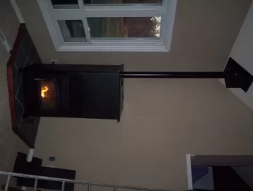

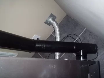

The vent is Simpson Duravent (we painted high temp black) set up with the cleanout T at a 45 deg angle, with 1-12" straight, a 45 deg elbow, and 2-60" straights to go up and out of the roof. I think I'll add another 24" to the top of the vent, just to get it MORE beyond the 12" minimum above the roofline required by Breckwell.
I also used a Simpson cold air kit, for 30 bucks it was well spent. Makes for a very clean installation.
Well, here's my pics, let me know what you think. Feel free to ask questions.

VERY nice!!
My door opens on the opposite side---that's pretty cool!
My install wasn't as complex as yours......it's already on cement and it's in the basement so it just went out the wall, right thru the foundation. And I thought about the hopper, but I don't know if I have enough clearance since I have a drop ceiling!
Good luck--it's been doing a good job for me!!
Elle
Looks very nice! Good work. We installed our ourselves as well. You will get over the nervousness.
Looks good.
Eric
I like........what did you use to build the floor pad, it looks great!!!!
First rate job, congrats to you and the wife!
Enjoy that bad boy!
mralias said:
what did you use to build the floor pad...
Read his post again, he explained it.
