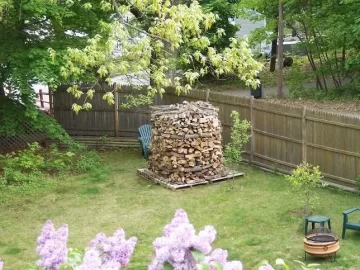

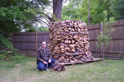

Woohoo!
ix feet x Six feet. Sits on 4 pallets. Sugar maple, elm, and whatever else I could scrounge.

Looking good! :coolsmile: A great way to conserve space.
Very good for 1st attmpt. Hope your puppy isn't too tired.
It looks like crap ya slackah.
Look at the dog- "Do I have to sleep in that thing?"

Very nice stack you did. I am thinking of trying one of these later this year since you don't need any posts for support at each end.
Thanks.
Wasn't that hard to do. Just had to make sure that I had a decent foundation. The ground in that part of the yard is uneven, so I had to heavily shim some of the pallets.

It takes a little more time (not that much), as you have to pay more attention to leveling rows. The inner ends of the pieces overlap, so you need cross pieces every few levels to even it out some. I had heard that having the middle higher helps- some people like "bark up" because they feel that it sheds rain better (like a sloped circular roof).

I did build my middle higher so that I could slope the roof. It's uneven, however.
Working on it ~3 times a week, it took me about 1 month . . . finished it 2 days ago.
