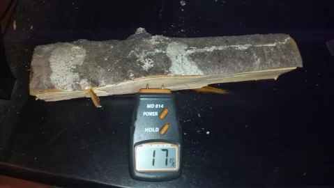

I split and stacked this fir a couple of weeks after it was cut down in October 2011.
  • [Hearth.com] Finally Bought a Moisture Meter - Surpising Results
