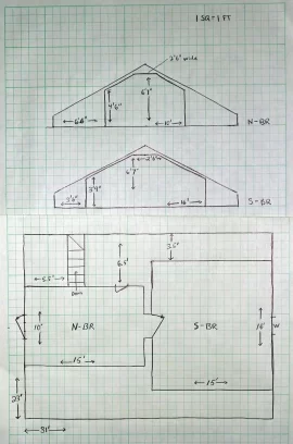

Here is a to scale sketch I made of the upper level:

The two rooms are different widths right now. The area along the outsides of the 31' edge and the crawl spaces behind the knee walls.

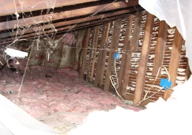

Here is a shot from inside the knee wall attic on the side with uninsulated plaster wall/ceiling...

There is no ventilation. That is what caused me to change direction recently. I had planned to add ventilation but in this house it would be nearly impossible and cause other problems. I've read this is typical problem with cape cods. For one thing I have no eaves. And only one gable end is exposed, and not really enough exposed space in the crawl space to put a decent size vent in. And the one bedroom that's more recently remodelled I'd have to tear out to ventilate and I don't want to do that (FG between drywall and roof, only way to ventilate would be to tear down ceiling and remove FG, and still no good way of bringing fresh air in). Some reading revealed the unvented approach can be ok... http://www.energyauditingblog.com/unvented-attics/

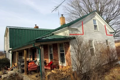

The cape cod half of the house. I drew red lines to show where the knee wall attic space was. Doesn't leave enough room to put a decent size gable vent to draw air in, and no eave vents. The front of the house the eave end adjoins the porch roof, on the back side its the same curvy white metal trim with rain gutters.
