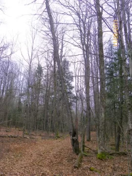

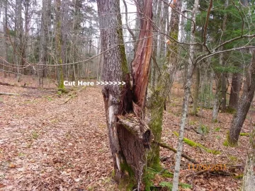

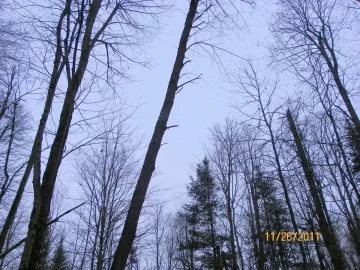

All three pictures are the same tree. In picture two would you clean up the backside then notch your front then make your back cut at the height I have marked?

Sounds good to me Zap, but then again I've been known to do some really dumb things. :shut:
Looks to me like you want to drop the tree in the direction it is leaning, that's a good start. But, if the crotch between the tree on the left and the tree on the right is as close as it looks you may need to notch (left side) and back cut higher up. You can come back and take the final 20" round out with a flat/straight cut, may need to have a wedge on hand.

Sounds like a plan Zap. Be careful that one has barber chair written all over it.

Yep, heavy lean.

in Detroit they call that a "Gansta Lean" but at least you know where it is going. There is something really cool about felling a tree but dog gone it can be precarious at times.
I would make a small notch just above the point where that short piece is facing you, ( cut that off first also) and then just plunge the saw into the backside between the main tree and that sliver sticking up. Shouldn't take a hell of lot to bring it down its got a pretty good lean to it. And clear out that snag on the ground so you don't trip as you move away after the cut
Kinda looks like old skidding damage? I hate those on the inside of the turns. I would probably do something real smart like sit in the bucket of the tractor and cut it well above the damage.
Zap, you have it right assuming the height is right. Those things are pretty simple to fell.
