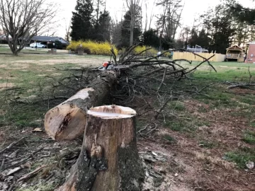

As the title reads, tonight I finally cut down my first tree! I have been bucking wood with the chainsaw for a few years now and small to midsize branches but never a tree. This thing has been dead since we moved here 3 years ago but have been so busy.
Came down perfectly, some kind of hardwood with some thick and gnarly branches. A lot of clean up but it’s down. Started cutting the small branches but ran out of gas and had to get the kids to bed.
Also had a cedar that was uprooted in last years windstorm that finally toppled onto another tree, bucked that too.
Still have a big ole dead pine to cut but it worries me. Natural lean to where I don’t want it to go.

May want to have a little more hinge judging by the pic, but that could be misleading. Also get yourself some wedges, can be quite the savior from getting the saw caught and it allows more control when felling

He is right. Need more hinge. Looks like both cuts were made at the same level, not sure if tree had major lean in your favor or not.Looks like a conventional cut too. I prefer Humboldt cuts 98% of the time.
Good job though, got it done without incident.

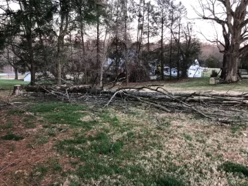

Yinpin....Now for the one in second pick in back right lol. Looks like a lot of good dead wood in that one if my eyes arent decieving me

I did cut the back cut inline with the first cut and realize it should have been higher. This tree definitely had a natural lean in this direction and there was really nothing in its way either way. I figured it would be a good first.
Actually the one in the back right is a giant maple of sort. It is alive and well and is beautiful once the leaves come. The bark issues at the bottom are from my kids. I caught them pulling bark off and hitting it with "swords" last summer. They have stopped.
I have a very large branch to cut off of the walnut tree in the back to its left as well. That one will have to wait but I will seek advice here first.

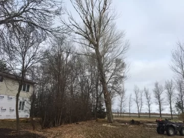

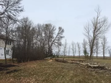

Kinda like what I had to do. Dead tree leaning towards house I renovated. I wasn’t taking any chances so I hooked up to it with a very long tow strap and pulled it away from house with my truck. Landed exactly where I wanted it to.
View attachment 243027View attachment 243028
Did you pull it down with the truck or steer the felling of the tree with the truck? I've got a skidding winch and could put tension on a tree in any direction.
Renovationman
Dec 5, 2017
47
MB
Just put tension on tow strap to make sure it fell in that direction. I made the cuts to fall that way but tree had quite the lean towards house. Strap was 50 % longer than tree height so no fear of it hitting truck.
Sent from my SM-T280 using Tapatalk
SpaceBus
Nov 18, 2018
2,801
Downeast Maine
Awesome.

Make sure your first tree is not be able to hit anything. Go the direction of the lean and top weight. If you don't you might pinch the bar. Learn to use wedges. Study the pictures of the various cuts and practice them. It looks to me the hinge was in the center of the tree. I try to make it 1/4 to 1/3 from the fall direction. Important to make keep the hinge the same dimension as you make the last cut. Just the way taught myself.
