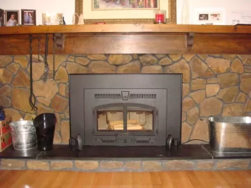

Here is a picture of my Declaration... Love its bigger (2.9cu') firebox for a flush stove!
edit: I paid 4300 installed with insulated liner. Maybe look around for a Lopi dealer and see if you can pick up the Declaration a little cheaper. They are the same stove both made by Travis Industries.

Bubbvah, nice looking stove and set up. I'm definitely considering the Declaration. If you don't mind me asking, what dealer did you go through? The Lopi dealer near me was asking $3,900 for the Republic 1750. I'm sure he'd want more than the $4,200 you paid for the Declaration. Also, what size room is in the pic and how many sq. ft. is your house?
My dealer was the Fireplace People in Berlin NJ
the room is 16x16 with an open floor plan
2300sq ft

Very nice looking insert, hearth and install! I like the clean lines and neat appearance..
