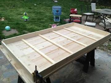

Okay...so making your own table is a lot of work. Today I built the skirt and attached it to table top first through cross sections (1x2's). I then used more 1x4's to add support where my breadboards (2x10's) meet the 2x8's. After that I attached the legs (4x4's). Every screw, and there is a lot of them was pilot drilled, then 3/8ths spaded so that the recesses can be covered with wood filler. Glue was also used. More sanding tomorrow and filling weather permitting.
