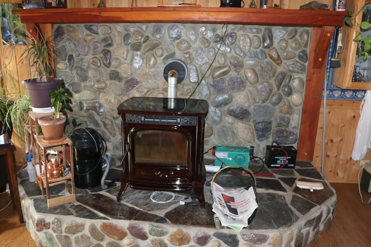

This Spring I went ahead and replaced our Blaze King King with Harmon XXV (Non TC). Dealer had Floor Model for 1000 off. Had unit installed by dealer. Used existing 8" Pipe with Adapter. No leakage of smoke when stove is just shut off by flipping surge protector.
What other things Do I need?

Been thinking of Long Term possibility without power. Have whole home Generator (7k) to run Pump and Lights. I have to will charge battery with generator. How long with 100AH battery run Stove in Manual Mode?
I plan on buying extra igniter to have on-hand next year. Good Online Source? Ebay results show bad reviews.

At any rate.. one thing to consider is that your 100ah battery is 12V and your stove runs on 120V. You'll need some kind of inverter to step the 12V up to the proper rate. Probably the most power hungry part of your stove is going to be the igniter. Trying to start the stove while on battery power, the inverter will drain the battery a good deal. The convection and combustion fans are the next biggest users of power, you can usually turn those down a bit though. Finally the augers... most pellet stove augers are only 1 A each so they will be a minimal drain on your battery backup.
For the money, your probably better off getting something like a Cyberpower 1500VA UPC (with pure sinewave output) and then splice in a set of leads directly on the 12V wires, before the internal inverter, to run outside the unit with terminals so you can connect to the terminals of the 100Ah battery when the power goes out. With a setup like that, and not using the igniter to fire the stove, you should get a pretty good long run time out of the stove.

Got the Aims Inverter yesterday and cables and device to monitor watts and amps. 400w almost on Startup and 122-112w on Normal max fan running. Ran the numbers and 2.25h on 35ah Genny Battery and 8.2H on 100ah at most for backup. More than good enough. Wife's not happy with "Industrial Look" and she will make box with holes for Inverter to Hide it. So about 1/2 that before Inverter stops process.
