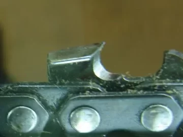

The big factors are knowing whether you've got the proper amount of hook in the cutter and whether the edge is dull or sharp. A common file guide used properly will establish proper hook. Using a jeweller's eye loupe or some other form of magnification, apx 5x will allow you to determine when the chain is sharp...then you'll understand why brand new chains get filed first.

It is very common for people to add a little "flourish" to their stroke which completely screws up their sharpening. Make sure your stroke is completely straight. Also, last time I checked, .325 chain needs 5/32".
