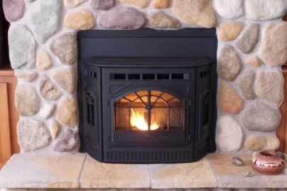

Did the install myself.
  • [Hearth.com] Fabricating custom surround panels for Mt. Vernon insert
That looks like a postcard for Quadrafire. Nice work!
