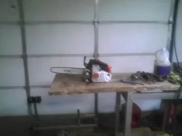

First saw lots of kick back but manageable once your use to it:

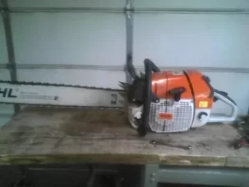

second saw very little kick back but very hard if it does:

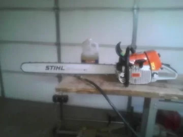

Thrid saw no kick back or if it does its just a push.

When that second saw cuts through that cable you're gonna feel a kick alright.
