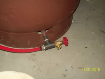

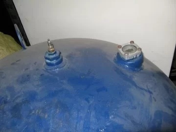

Here's one I made from a 124 propane tank. Paid $60.00 for the tank. Works great. Has a float gauge built in so
don't need a sight glass. just added the drain / inlet on the bottom and in air valve in an existing hole on the top.
Has a valve to shut off from the system on the other end of the pex for precharge / drain tank if ever need to. It's
stayed at the same water level since put in use.

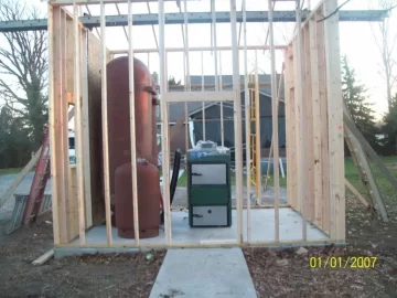

I really like some of the home-built expansion tanks I've seen on this site in the past year or so. It's a great way to save a chunk of change. But I will say that you can't beat the bladder tanks for ease of installation and use. But it comes at a price. I have (2) 60 gallon tanks on my system...

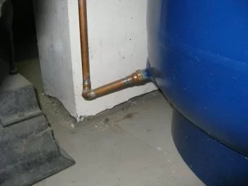

Like Woodmaster, I used a 120 propane tank. I removed the valve and fittings, installed plugs and a tee, and mounted it upside down on the flange. I didn't have a hole in the bottom, so I drilled and tapped for a tee with shrader valve. From the tees I ran a sight tube top to bottom. I am plumbed into the bottom of my 1000 gallon propane tank at the return with about 10 feet of 3/4 tube to the 120. I never see any hot water in the 120 once I am up to temperature.
Tom
DIY has worked great, been in use for 3 years.
Rob
