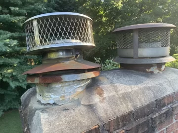

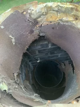

Was hoping someone can give me some insight/advice. Just recently moved into a house with a brick chimney.
Noticed the rain hood was loose and when I got up on the roof and looked down the chimney I noticed that the liner was completely rusted.
After some research, I realized that I don’t believe it was a liner in the first place and that at some point they ran double walled chimney pipe up the chimney (see pic).
1. Are my assumptions correct?
2. Can I removed this and use a flexible SS chimney liner?
3. Any ideas on how to pull this out of the chimney, it is heavy as all heck and barely budged.
It is venting an oil furnace and an oil water heater. Thanks!!
