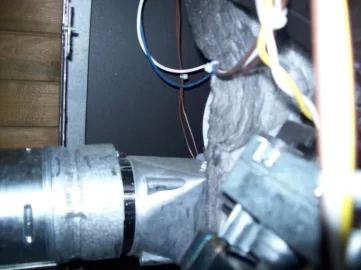

exhaust pipe clamp on Big E
pellet9999
Sep 3, 2008
119
ny
here is a picture of the stainless inner sleeve fitted over the exhaust port on a Big E. I was going to hold it on there with
a stainless hose clamp,screw type. Does this sound ok..??
  • [Hearth.com] exhaust pipe clamp on Big E
This has been discussed many times lately. Put sealant on the joint and hold it in placed with three evenly spaced screws. You will have to drill the holes for the screws.
