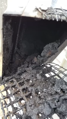

[Hearth.com] Excess creosote at pellet stove pipe termination [Hearth.com] Excess creosote at pellet stove pipe termination [Hearth.com] Excess creosote at pellet stove pipe termination [Hearth.com] Excess creosote at pellet stove pipe termination [Hearth.com] Excess creosote at pellet stove pipe termination Why do I have so much creosote at the end of my pellet stove pipe termination?
Here's a brief overview:

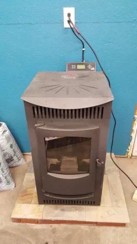

Stove: castle serenity
Pellets: Greene Team Platinum Hardwood Premium from the big blue box store.

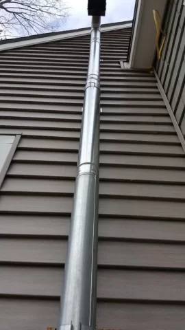

Approx. 12 vertical feet of pipe and 1 foot of horizontal run from back of stove to the T.
It's in my workshop and mudroom area, approx. 400 sq. Feet so I don't run it at fI'll heat much of the time and usually leave it on the thermostat setting around 65. I realize not running it at a high temp all the time can create creosote, however I don't understand why there is so much jammed up at the end of my pipe run.

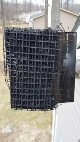

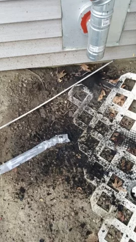

I cleaned the stove pipe today for the first time since purchase back in early December and was shocked by the amount of creosote clogged up at the end of my termination. I added a screen to the end of the termination as a spark arrestor as I was seeing lots of live sparks fly out the end.
How can I prevent this creosote build up in the future? If I didn't have the screen there would all this just be landing on my roof and ground?

I'm not sure why there is creosote, but the screen is clogging and restricting the air flow too much. If you're concerned with the fly ash there are buckets that will catch that. Such as this: (broken link removed)
Hopefully someone will be able to explain the pile of creosote.

I don't know your stove specks, but 12' pipe along with burning at low temps and the addition of the screen may all play into it. Also depends on your fuel quality

Your outside pipe is dropping the the temp so the H2O is condensing and creating the collection of $#!*. That's alot of outside pipe
I'm going along with Bioburner. Can you reduce the 12' vertical to 6' and see what happens? Probably a window in the way?
While I appreciate the concern for sparks, the multiple layers of screening at the end and the long outside of run of venting are generating part of the problem. As suggested above, see what you can do to reduce your vent height. If an OAK is installed, you can reduce clearances to 18". It is recommended that there be a 3' vertical rise but I think some owners may have a horizontal only... Hard to tell what your clearance to ground is...
Not sure if the vent cap gets included as a 5 when calculating EVL but, if it does, you are pushing the limits of 3"
1' horizontal = 1; t=5; 12' vertical = 6 EVL of 12 w/o the cap
