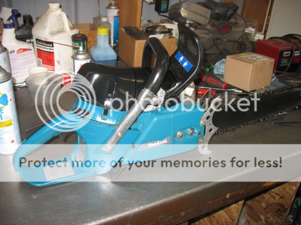

This ^^^ Bought mine for about $240 OTD it is 2 yrs old with 200 rentals on and it's still a good saw. My plan was to buy a BB kit or the 7900 P&C but I just can't justify that right now. It does everything I ask of it for now.
One thing I don't like about it is the dawgs just look ugly to me and it seems like they "use" up a lot of bar space. So I drew up some custom, low-profile dawgs, more in line with that of a Stihl 034 or such and gave the drawing to a friend with a waterjet. I'm hoping to have my new dawgs within a couple weeks.
you might have a market for those dogs, depending on shape and price. Lot on arborist site dolkita fans. I for one would like smaller dogs.
the air cleaner kit sis about $70 and I think was worth it. The original is just too small, slivers move through. as the air velocity through it is high. The new cover looks funky and needed some vinyl spray paint but once grey it looks ok. Andit stay clean forever.
k
Ouch. Don't go gray. Black hat is the way to go!
k
I figured they would be a hit once a picture of them. I'll keep that in mind if I decide to sell them.
