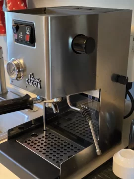

This will surely be one for @Jan Pijpelink and @AlbergSteve (if he's still around), hopefully a few others will get a kick out of it. Just like my splitter, I've hot-rodded the espresso machine. The job, for fun, was to give a $500 machine all the capabilities of a $3000 machine.
The platform was the venerable and ubiquitous Gaggia Classic, mine the lowly 2018 model. The mod's:
1. Added PID control for brew temp.
2. Added SSR off PID alarm outputs for steam temp, to adjust steam pressure.
3. Added potentiometer to pump circuit to permit pressure profiling.
4. Added 1/16" tapped hole to top of boiler (head space), for connection of boiler pressure gauge.
5. Added Isomac 16-bar boiler pressure gauge with capillary.
6. Added LED light to tank, to check fill level.
7. Adusted OPV spring pressure to sub 10 bar.
Many of these mod's are common enough, but what makes these unique is:
1. Pressure gauge is tapped into boiler, rather than tee'd into pump.
2. PID is mounted internal to chassis, rather than hanging off the side in a project box.
3. Potentiometer is mounted internal to chassis, rather than hanging off side in a receptacle box.
4. SSR's for brew and steam are both mounted down inside the chassis, rather than hanging off the rear vents.
Before:
![Espresso machine mod's Espresso machine mod's](https://www.hearth.com/talk/data/attachments/294/294766-4e67b354889183d34ac29c0e0731dec1.jpg)

Investment was somewhere under $200 on a 4 year old machine, well worth not spending several $k to obtain the same shot profiling and control capabilities (albeit, with a larger or even double boiler).
