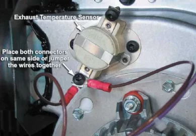

until you get a switch you can jump it and run it with the switch jumped
The blower will stay running.
you will have to Unplug the stove 30 minutes after you shut off the auger to make the stove shut off.
I know the switch below is not the same but you would do the same thing.

Yes refreshed and F5 too. signed on with another address and got it. THanks, order is in.
Also I ran a jumper to the terminals and have a nice warm room for the first time in two weeks. Thanks again.
