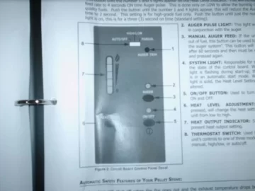

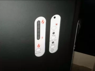

In perpetration for my Tstat I started looking again at the option I have for the MINI and the manual I have is showing a different looking control board then my unit has, can you tell me which board yours looks like, the one from the manual or the picture of mine?
The Manual says it has a AUTO/OFF – HIGH/LOW- MANUAL switch at the top of the control board, but I don’t seem to have that

Ok It turns out that I have two sets of manuals for the MINI both are 50-1220 but the one I downloaded off the net has different pages from the one that came with the stove. Turns out that ON/OFF and HI/LOW etc… are set by jumper.

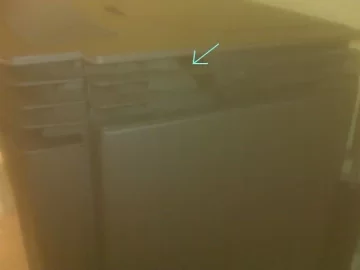

yeah i was able to get an 05 floor model in a month of going in, and installed in SEPT!, so i took it. my date is on the label on the back of the ash pan door take a look
Mine is dated August 2008.

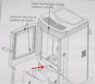

Now this is on a 05 model. sorry for the crappy quality my good camera is unavailable right now.
