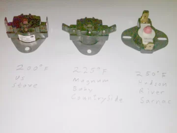

If you can, find out what the trip point is on the Hi Limit Switch or Snap Disc. From my experience it should be 250 Deg F but I have seen 225 Deg F in the Baby CountrySide stoves and 200 Deg F in the US Stove 5660. I have replaced the Hi Limit snap disc switches in both of these stoves with a Selco L250 that trips at 250 Deg F and then never had a problem with them shutting down again. If for some odd reason they have a hopper fire, then they are still protected and will shut down. Many other stoves I have seen use the L250 Deg F snap discs.
Also the Vistaflames have a steel firebrick backing where the Enviro's have a cast iron firebrick backing so check for cheaper parts!

I just found it on page 7 of the VF55 manual, the Hi Limit Snap disc is only 200 Deg F ! ! ! This seems very low! I would change it out!

Here is a case where burning hi heat pellets on heat level 5 will shutdown the stove with the 200 Deg F Hi Limit snap disc! ! !

That is a different stove. Changing the High temp switch? May cause worse damage.....
It all depends on where this switch is placed. That extra 50° may mean a lot.
Enviro/Regency/Vista Flame (Sherwood Ind) has already came up with there own fix. They have introduced a larger CFM convection blower and also a feed/slide plate in the hopper (restricts feed).
Changing the disc will only allow for higher temps (not good IMO).
Just because a stove hits its high limit, doesn't mean you raise that limit....
My old Englander (17 yrs old), is the only stove thats hit a high limit. But I was cranking it! No other stove I have, or that I have installed, or seen, has hit the high limit.
Maybe a sister stove that has similar parts.... Can have a part like that replaced. But I wouldn't ever just up the Over temp on a stove, just because another model has one that high. My opinion.

Hi Dexter
Thanks for your opinion from what you have seen. That's fine for those stoves.
You are very correct it does depend where the switch is placed. Thanks for the Info!
My Astoria has the 200 Deg F Hi Limit Snap Disc on the bottom of the hopper.
I see that the Hudson River Sarnac with a 250 Deg F Hi Limit Snap Disc has the exact same metal shell as my US 5660 with the 200 Deg F Hi Limit Snap Disc on back of the burn chamber! This is a hotter place!
This poor guy in Rhode Island, also has the US 5660 like mine and when he used it on Hi Heat Level 5 it shut down during a very cold winter night and was almost freezing by morning!
See
https://www.hearth.com/talk/threads/us-stove-5660-damper.78719/#post-1003621
That can be dangerous with water pipes freezing and what not! ! !
If there is a fire it will still trip the 250 Deg F snap disc no problem, but I would not want the house to freeze ! ! !
Same with the Baby CountrySide even the 225 Deg F Hi Limit switch trips too easily ! ! !Even though it is located on the bottom of the Auger chute, I just bumped it up to 250 so my friend would not have as much trouble. She could not reach way in to reset it. It was a real problem for her! ! !
See pic below of the 3 stoves and their Hi Limit Snap Discs. Click to enlarge!
I am beginning to realize that some stove designs do have flaws, and if I can correct them to make a more reliable stove then I certainly will ! ! !
