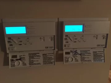

Hi radiorental!
Roundabout suggestion, you could us two dedicated t-stats. My insurance company rep, suggested a separate t-stat.
Easier for us and family members.....Maybe another M55 owner can shed light on a dual t-stat setup.
Bill

Hi radiorental!
Bill
