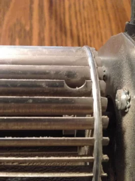

Me Bad!,,So after about 5 continuous hours the sound came back...I quickly took off both side panels and confirmed that the sound was about the same on both sides (which to me, eliminated the combustion blower) and put the sound squarely on the convection blower.....me thinks! Since I was lucky and only had a small flame at the time (toasty 72) I decided to unplug my stove from my UPC and see what happen to the sound! No power the fans must slow down and stop.....the convection blower where I believe the sound is coming from started to slow down.....and the sound slowed down.....until the very end where all I had was the tick, tick, ticking sound as the fan came to a stop.....a minute later, I plugged the stove back in and the ticking noise quickly spooled up as the fan speed quickly went from zero to fan speed....So me thinks, that there could be some obstruction that is hitting the blades.........but why after 5 hours? Even weirder, because I wanted to make sure that the stove cooled down properly, I plugged the stove back in.....the sound resumes but it is intermittent, I now have the stove in shutdown mode but the sound is there one minutes and not the next.....?? Could it be bearings....? The only thing I can think of is a bit of sheet metal along the length of part of the fan blade is expanding and touching the blade, but only at certain temperatures....Is that even possible? Can't pull the stove out until this afternoon! I might have to call Enviro...
