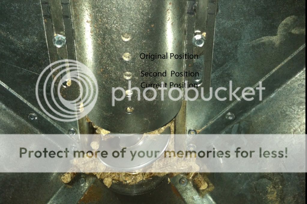

on my stove i can see about 2" of the auger.is that roughly where yours was set and how much did you slide the cover up when you made the adjustment.maybe you could post a pic

I raised the auger cover plate from its initial position which was the second hole from the top of the 5 center holes where you could see the bottom edge of the auger housing thru the hole. Initially I raised the cover plate to the center of the third hole and it made a huge difference. I raised it somewhere in between the third and 4th position but have not had a chance to test it since its been quite warm here the last few days. The spacing from the bottom of the hopper to the bottom of the cover plate is now about 2.5 inches. In the pic, you can see the marks indicting the initial positioning. It is 1 inch from center from the original position. Having read Flynfrfuns post, I may just open it up all the way. Anyone know when they started using the new blower. Although my unit is new, its manufacture date was June 2011.

Keith, Not sure if you have the new blower. If you look at the convection blower located on the right side of the stove( if your looking at the front) the end on the new blower is round black plastic and the old version was square black plastic. there were some pics posted here last year but I dont know how to find it.
thank you guys for all that info and for the pic.when temps drop a bit i will test it with the cover plate all the ways open.cant wait to see what the difference will be.was getting pretty bummed out with the heat ive seen so far.
