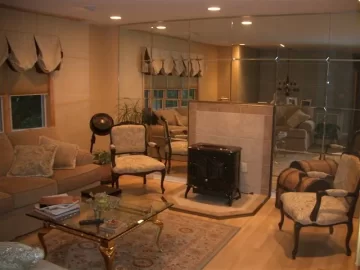

will this come out the hopper or do I need to take the stove apart?
I can try it once my pellet level goes down.
