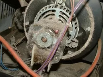

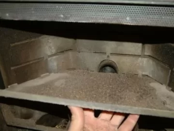

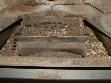

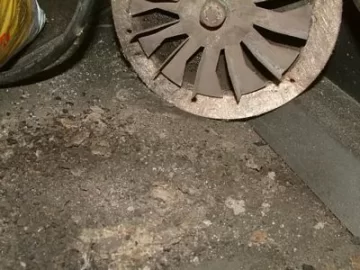

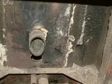

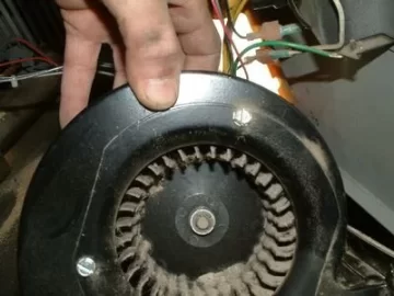

Hey Guys, decided to take pitty on the 9 year old stove today and give a good cleaning, noticed it was getting Dark Yellow Flame most of the time, so waited till it was 20 Below to tear it apart, lol.One thing i wanted to point out, never run across it myself in any threads is MAKE SURE, to take out the little tray directly below the Heat Exchanger and Remove the Fly Ash, my wife had been doing most of the 2 time/week cleaning and had missed this for couple months, My Bad, maybe i forgot to tell her it was removeable,heh.After 1 hour or more cleaning this stove this morn,completely disassembling it,and scouring it.This thing is really performing now,its just over 12 O,clock position and over 80 in here,minus 5 F outside and dropping to minus 30 F tonite.Glad i did it this Morn..
