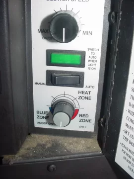

MountainSean said:The stove works for 15 minutes before it turns off on startup if you don't switch it to auto. With an EF2 you hit the start button and wait for a fire to start and switch it to Auto once the green light has come on. The Igniter itself should start up immediately though it can take a couple of minutes to reach it's top temperature and it should stay hot until 15 minutes has finished or you have switched the stove to auto.

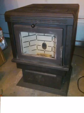

charger1966 said:My EF2 won't burn with the heat controls set lower then halfway. I have tried several different brands of pellets with the same results. I have cleaned the stove extensively by taking out all the foe brick and the insulating panels. Blew high pressure air through every port and it still will not burn below halfway. Any ideas out there? Thanks in advance, Lance
Ok sounds good I hooked it up direct to an outlet to see if I would be getting any more kick out of the blower and it was the same as it is now. Curious if that's just the way the stove is or could I have a weak blower motor just not really kicking heat out. not like some stovse I have seen lately.Hi Evi yes sounds like the rheostat. Ideally if you take your blower out, make a test cord and have another rheostat to add in line to it, (as stove techs like myself have) thats the best way to test it. I'm looking for smoothness with the motor removed and of course to clean it. Be careful if you do any wiring testing, 115V hurts... I know that too unfortunately.....
