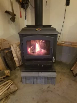

So, the 30 has been in the garage for 3 weeks now. And I have some questions along with some observances. Pictures below for reference and I know the logs are close, I was knocking some snow off them quickly.

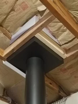

Picked this for $400 off Craigslist. Came with a few cracked bricks, no big deal. Came with the optional AC30 fan, good deal. Spent more than $400 buying the piping and whatnot. All installed in garage with insulated roof (pictures below)

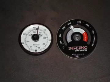

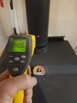

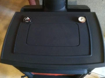

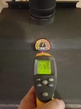

1. I finally got my hands a IR gun today from work. Its a mid model Fluke so I trust it over the Rutland STT. The stove top was over 650°F at one point tonight while the STT was only showing little below 550. Is this normal? If so, there a better STT to run? Picture below for reference on temps difference. Can also see my screwed up stove adaptor I plan on fixing next year.

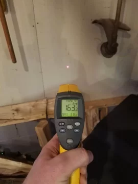

2. I have all the correct clearances beat by inches all around. The left side drywall that is 23" away (pictured below) was reading over 165°F. At what point should I worry about drywall and or exposed 2x4s?

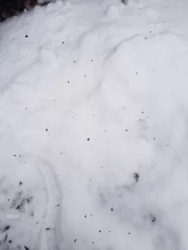

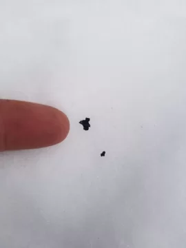

3. Noticed black flakes on ground in snow when I came home today. My wife said she didn't run it over 400. With 2 kids under 2 she tends to let fire go longer than needed and not attend it much. I'm ok with that. When im home i usually run 450-500 with 18-25% MC various wood. The flakes crumpled between my fingers but there seems to be a lot. Any clue what they are? Paint flakes from brand new single wall? Creosote chips?
4. I'm still getting a strange "hot" smell when STT reaches around 400°F. Would have thought the paint is baked in by now on the single wall sections. And all pipes are facing right way with no leakage coming down. I took apart the top 2 sections of 3' triple wall thinking I was already creosoted up, but was really still very clean. And also stove was bought used so it's not stove paint. Thoughts?
