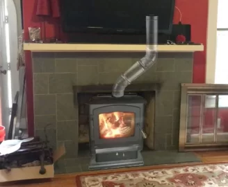

Plan: Install Englander NC30 (with legs, probably shortened) in my existing (ex-gas) fireplace which hasn't been used in 15 years. Install insulated liner in existing straight 8x11 clay lined 20' exterior chimney. Fabricate block-off plate. Maybe extend hearth with tile.
Issues: It looks like it will be pretty straight forward install except for the flue being offset from the middle of the fireplace. It is on the far right side of the fireplace and I'm not exactly sure how I should go about attaching the Englander to a flex liner. My thoughts were to put a 45 adapter on the stove flue and see if the flex liner can make the turn to attach to it. It looks like it will work. If that doesn't work I can maybe put another 45 on the end of the liner.

Here's a mockup of what I'm thinking:

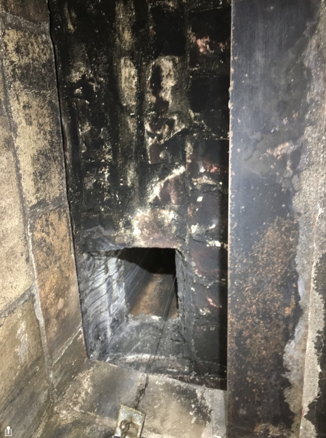

The top showing the offset (this is AFTER the chimney sweep left today)

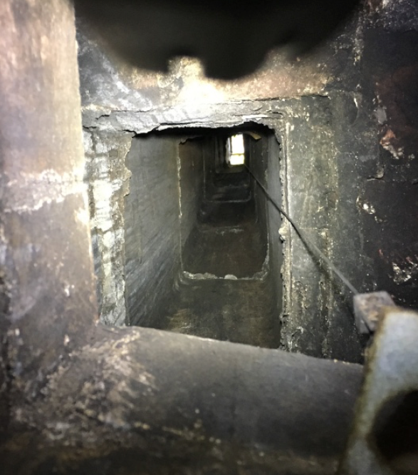

Finally a good shot of the inside of the flue:
