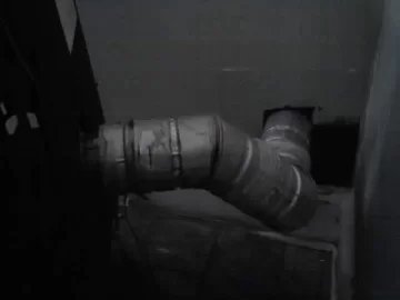

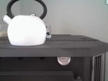

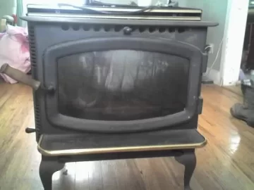

It seems there is alot of knowledge here so here goes.... my wifey got a GREAT deal on a 25-PDV {it was purchased from Lowes and returned 2 days later with a bad igniter, igniter was replaced and she snaged it for $420!!} so I replaced my circa 1991 avalon {throws a ton of heat, noisey fans, hopper too small, no igniter, a PIA to clean, sticky switches ect..} with this beast..{read HEAVY} englander. Of course as my luck the exhaust on the PDV is higher and on the other side so I used a 45 and a 90 to "engeneer" it into place wich i plan on "doing it right" when the temp gets above freezing. I judge performance by stuffing i bbq thermometer in 1 of the tubes. I also dont have the OAK hooked up yet, but it is in the works. thats the back story, now for the problems. I cant get the PDV to make anywhere near the same heat as the avalon did. The avalons blower used to come on at 200 and at "low" feed would stay there, if I cranked the feed to "high" those tubes would hit 375-400.. The PDVs blower comes on at 140 and drops lower once the fan comes on, no matter what settings I try I cant get it to break 200. heat at 9 fan at 1 {chewing through pellets} gets me to about 200. now the exhaust pipe on the avalon you could wrap your hand around {unless it was crankin} now the PDV sizzles water off instantly even on low heat. I thought i was plugin the xhaust with the screwed up angles but the pipe is that hot on the 3 foot straight run AFTER the corners 2. Would a exhaust restriction lower the firebox temp? also the blower doesnt seem to change volume much between 1-9. dont get me wrong its working but you just dont feel much of a diffrence of volume on any setting. i included a few pics incase it helps..and i look foward to finding out if i screwed something up...
ps I think the flame is fine, bright yellow licking half-way up the fire box and no visible smoke out of the exhaust...

Does sound like a bum stove though. Difference between 1-9 blower settings are huge. Where are you measuring temps, at the location of that therm in the photo? I have a thermometer at the left front corner of the stove, magnet deal like that, and can max out at about 450* with hot pellets. For what that's worth. I tried to find the hottest part of the stove since then I can look at the widest range of temperatures, to figure out pellet quality, stove efficiency, etc.
