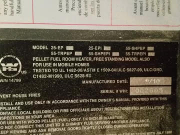

This is our second season using an Englander pellet stove. We acquired it used from a family friend. I'm not 100% sure of the model number, but it looks just like the pictures of the 55-SHPEP and 55-TRPEP I can see online. Our stove only has one auger and auger motor, if this provides clues as to its model. The installation and operation manual that came with the stove is for the 25-EP, 55-SHPEP and 55-TRPEP models. The name label on the inside of the hopper lid has many model numbers but none of the boxes are checked. (See photo) The stove was manufactured in September 2010.

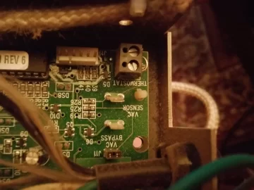

Which of the two is not in use. If you do not use a thermostat you must have that jumper installed.
The thermostat is not in use. This is what the inside of the control panel looks like. (I apologize that I don't know exactly what the jumper is.)
  • Englander 55-SHPEP Pellet Feed Rate doesn't change
If the screws are tight everything should be fine, it is hard to tell from a picture but the lower of the two screws looks like it might not be making a good connection you might want to check it and be certain the stove is off, cold, and unplugged.
The stove not changing feed rates indicates a missing t-stat jumper, a t-stat circuit not calling for heat or damaged, or a problem with the control board.
There is a test procedure to check that thermostat circuit to see if it is seeing the t-stat or jumper, however I don't know what the magic button presses are to activate it and to go through the various tests.
I suspect that your stove thinks it is running on a t-stat that isn't calling for heat.

If she switches from "on-off" to "hi-low" , the stove should maintain a low burn instead of shutting off, correct?
See page 31 in the manual and let us know what mode the t-stat circuit is in.
