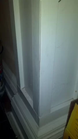

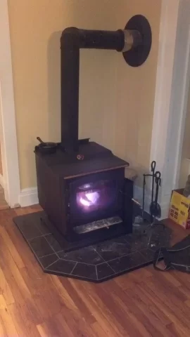

heres some pics of my install. on the front right side of the stove the wood corner column like trim is getting pretty damned hot. the paint hasnt bubbled but you can see its dried it and seperated the joint a bit. looking at the available heat shield it only extended half forward from the back of the stove and probably wont solve my issue. thought of haveing one made that would extend all the way to the front with maybe a leg for support? ideas?
