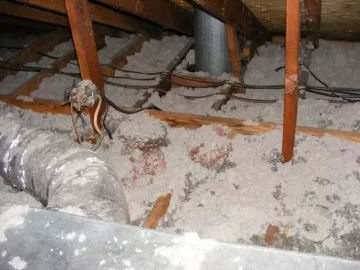

This pic shows the relation of our stove pipe to the very end of the main trunk at the west end of the house. We assume there will be two bends in order to attach the hot air pipe thru the top of the trunk.
The main furnace unit is to the right out of frame. We figure it would take about 6' of pipe on a diagonal to make the connection to a more central part of the trunk, closer to the main unit.

Ugh! Upon really examining the pic, it occurred to me that the hot air line may run smack into that rafter! Does anyone know how many inches there are between the flue and hot air hook up on the 28-3500?
Thank you!
