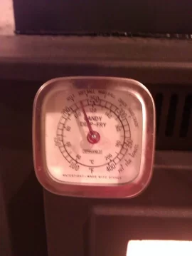

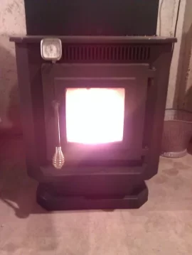

Heres mine cranking on 9-9
The thermometer is touching metal as I had to cram it into the slots.
Don't tell my wife her thermometer is missing. :lol:

superchips said:
Change your setting to 3-2-1 and retest.
Changing to 3-2-1 is just gonna mean the same burn. But gonna have to run a higher setting to get the same results. Dropping each # 2 points will mean what he got on 5. Will be what he gets on 7 (if he changes). 5-4-1 or 3-2-1. Just means less air and less fuel, but in the same increments, it may show no change. Other than longer between cycles. Which is the problem now.

Seems like you need more fuel. Burn didnt look bad on Youtube. Although that was a very short clip. Can you post one long enough to show the Fire cycling up and down? BTW-Awesome Forum name... Do you "Ride" (Bikes, ATV's, Etc)
