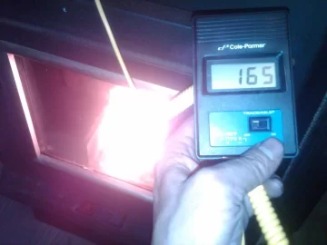

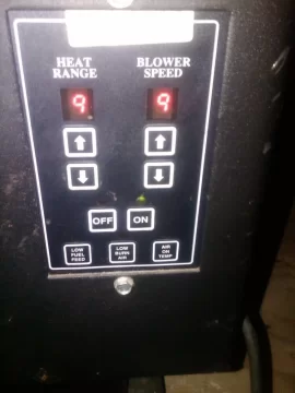

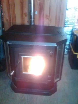

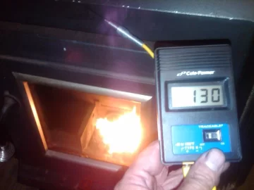

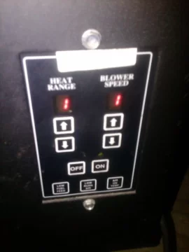

Hello
I have been testing this Englander 25-PDV heat output.
With the stove set to d Program Mode and the Bottom 3 Buttons on 6-6-1
It has a 250 CFM Room Blower so that is alot of hot air blasting!
The digital hight temp probe thermometer measures:
Heat_Level__Room_Fan____Temp_Deg_F
____1___________1__________130
____9 __________ 9__________165
Does anyone else measure similar results?
See Pics Below

I assume you know that the left side blows out significantly hotter air .
No I did not know that. I stuck the probe in the middle hole.
Why does the left side blow hotter air?
It`s closer to where the hot air exits the heat exchanger.

Also, how long were you running on 9-9? In order to have an accurate reading of what temp that setting gives, the stove should be ran there for a minimum of 30-45 minutes to completely heat the stove up and let the temp settle in.
Seems the air temp should be Much higher than that on 9-9.

Guess I should have been more specific. Going from one heat level (say 5) to another (in this case, 9).
Within 45 minutes, the temp will plateau. From a Cold start it may take longer. But some stoves do heat up faster than others. My Quad heats up like a Rocket. While the Englander and Fahrenheit take a little longer. But none of them take 3 hrs. Maybe an Hour. At best.

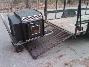

Hi Dexter
I do have the larger 25-PDV (375 lbs with the side grates!) actually it is the 55-SHP22L from Lowes because it has the Nickel Trim. The Nickel Trim looks like the only difference.
Yes, Dexter I only had it on 9 - 9 for 15 mins. I was not sure if running full bore for a while was OK. I did smell a funny burning smell.

To get a true temp reading, you need to burn longer than 15 min. That smell is just the stove burning in again. It probably has not seen heat setting that high in awhile. So all the oils and dust will have to heat up and burn the stink off.
Its Safe to burn that unit on 9-9 for an hour to see what its got. In the manual, it says to run the unit on 9-9 if using a stat (IIRC) this isnt a unit that needs to be babied. When I run mine, Its normally Full Bore. And mine is almost 17 yrs old. I have a pretty large area to heat with it. 50 x 25 insulated o.k. to todays standards. But still has leaks and drafts out the A$$.
Cant you hook it to a stat? Yours should have that option?? No?
(Edit: I am not recommending that you run the stove on 9-9 all the time, nor when its on the stat. Just stating that an hour wont hurt at that setting. I dont like to run anything Wide Open for to long.)

The 25-pdv I have puts out the most heat when there is a mound of burning embers on top of the burnpot. I cannot get temps above 200+ unless this happens. This usually takes 3 to 4 hours. There are other folks in the Caribou area that have 25-pdv's and their stoves need the same amount of time to get up to temp. Oh, and we all burn in C mode.
