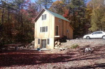

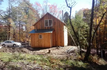

Hi guys and gals, I am a long time lurker but first time poster. I love the forum. I am hoping to gather some input form the knowledge base here. Here is my situation, I just finished building my new house and I can't keep my englander 17-vl from cooking me out of the house and also I can't get burn times of more than 4 hours. (and when I do the thermometer is always over 80*f.!!!!)
The house:
super insulated timber frame cabin. super tight and no thermal bridging. open concept. Small!!! Main house is only 18'x18'. 2 stories with insulated (on outside of concrete) walkout basement. located in central NH.
Stove: Englander 17-vl, on 1st floor. (living room) Dura tech 6" straight up through the 2nd floor and out the roof. Mega draft!
Wood : 2 year seasoned mixed hardwood
So I underestimated just how energy efficient this house would be as well as just how much heat the little Englander would put off. I am trying to find a way to heat with this stove without cooking my self out and also try to get longer burn times. I want to stick with wood for many reasons.

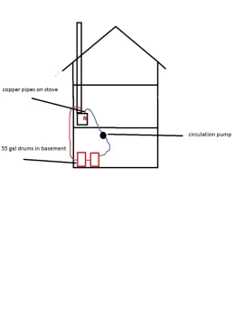

4) build copper coil heat sink for on top of stove and circulate heated water to basement 55 gallon drum storage for heat storage and slow dissipating (see drawing)
If anyone has some input please post up. Also I have attached some pics to help explain.

Neat little house. So the little 17 is too much? Wow - wish I had that problem. Anyhoo...lowering the temp yet extending burn times is gonna be tough for that little guy. What kind of stove top temps are you running? About the only thing I can think of would be staying at the lowest end of a 'safe' burn temp.

I kinda like the venting of air to the basement idea. Not real fond of the heated water idea unless it was well thought out.

Maybe move the 17 down to the basement? If possible design a safe water heating system that works without a pump required.
I get the feeling that if the stove was in the basement I would not have any problems however the basement is used for my dogs and they would not be very happy with any extreme heat spikes. Also I think you might be onto something with a properly designed water system. maybe this is something I should post in the boiler room section as well.
