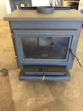

I just picked up a Englander 13-NC I did not know what it was until I got home and looked it up on the internet. I was very excited to see the secondary burn tubes with the insulator board.
It is missing the ash drawer and the bricks but other than some rust the stove is in very good condition. When I install the bricks I naturally would cut them to fit around the hold for the ash clean out. But is there anything else that sets in the stove to keep the ash from falling in the hole when the stove is in use? And what keeps the stove from drawing air into the fire box from this ash clean out hole? Again thanks
