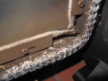

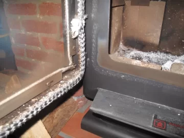

The glass is really clean except for the two bottom corners, so I took a close look at the gasket yesterday and noticed that they are a bit loose at both those corners. It looks like at the factory they installed the glass gasket beginning at a corner, but the brackets that hold the glass and gasket do not extend to the corners, thus the left corner being especially sooty. Then, I noticed that along the bottom of the face of the stove, where the door gasket presses, it is really sooty too.
I'm pretty sure I should replace the glass gasket but what do you think about the door gasket?
