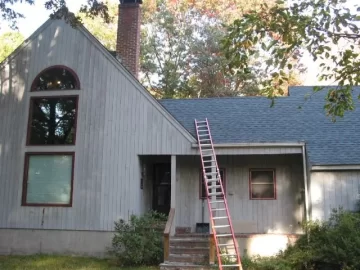

I've attached a couple of pix that show the outside. The one with the three windows is looking at the West end of the house, with the existing chimney. As a scale, a standard 36' extension ladder (32' working length) won't quite reach the chimney where it meets the roof... The three windows are all one room, the living room is 24 feet floor to the peak of the roof (when our ceiling fan died, I had to rent and erect an 18' scaffolding tower in the living room to replace it!)
The lower section in the middle is the laundry room, which connects to the garage, who's roof is east / west facing.
The second picture shows the collapsed porch, on the other side of the laundry room. The bay window is the kitchen / dining area, and also needs replacing - the only reason it doesn't leak is because I've been really generous with the calking gun... The red door goes into the laundry room, and the bulkhead goes into a room in the basement on the opposit end of the house from the chimney.

Essentially I have flat ground, and a fairly short distance... If you saw the photo of the collapsed porch earlier in the thread, the wood sheds are just outside the picture on the left. If I just had to put wood into the basement, I'd agree that a chute would be great, but I also need to feed the stove on the first floor as well - the way the house is layed out, ground level is about half way between the basement and first floors, so I need to go both up and down with the wood... I also have a strong desire to make anything I do as much of a solo task as I can, the GF is not in good shape physically, and has poor stamina and coordination - I've learned to avoid trying to have her help me move things, as we usually end up mad at each other, and often tend to hurt each other when she fails to properly do the "mover's dance" The wood elevator would do both the way I'm visualizing it.
