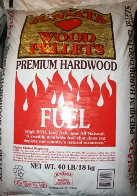

I really did not like the Juniata pellets from '09/'10. Dark, dense pellet but left me in "clinkerland".

Can you tell me why some pellets (like the Juniata last year and the Tri-State Biofuels this season) leave clinkers in less than 6 hours of burning, while others like Potomac (yellow pine) and this years American Wood Fibers (hardwood) do not? I could let the Potomac and AWF burn for 12+ hours and all I have left in the burnpot is ash, no hard clinkers. I can only deduce that the dark colored, dense and shiny pellets like the Mifflintown, PA produced Juniata (Energex) brand have more dirt and minerals in them than the others.

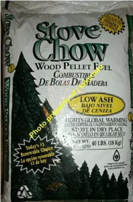

Back to the OP's question on energex pellets, no, $265 is IMHO too much for energex and I'd go with the stove chow.
