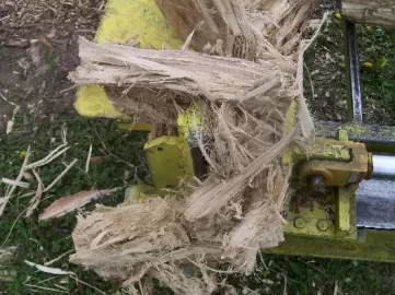

Live elm. When you cut this it is really full of sap. When you split it, nasty. It is the toughest wood there is to split that I've ever seen. It will end up very stringy after split and this is one reason it will dry fast. It is also one reason it will burn fast after it is dry.

Most of the elm I get is standing dead until the bark is off then you can cut it and it's about dry enough to burn right away. I would rate it a little below ash and oak I keep it in the stack with those woods for long burns on the really cold nights. When it's dry like this the splitter has no problem with it and it does not shred like the fresh wet stuff does. This is one of the few exceptions in wood where I will cut rounds and if it's pretty wet I will let it sit like that for a good while then split it.

  • [Hearth.com] Elm
