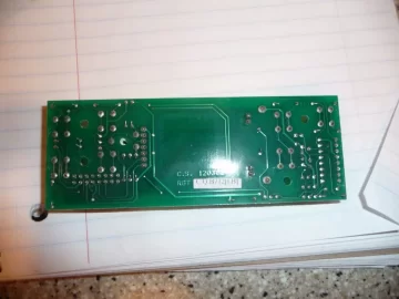

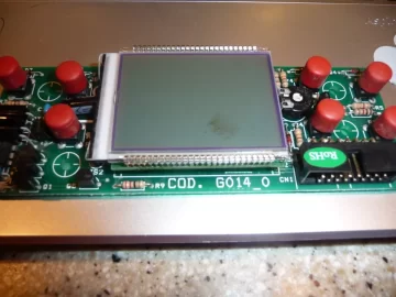

I had an electrician friend, Jay, test the P3 key an indeed it is dead. All of the other keys on the display board work. I am going to try to fix the P3 key so I purchased a few momentary switches from DigiKey.com (very helpful people on the phone) for a whooping $1.35 plus $7 shipping. The electrician will solder the best fit switch in and we'll see what happens. In the worst case, I will have to buy a new display for approximately $200 ;hm. Or perhaps I might take you up on your offer to try to fix it!
Thanks for getting back to me so fast, it is greatly appreciated. I will post my progress later this week.
Chilling in Jersey

Looks like an easy fix, that switch type is easy to replace. Make sure the tech handles the board carefully, to avoid static discharge which can kill the board.
