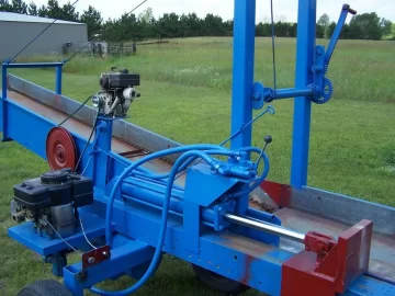

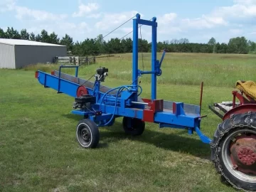

You can see in my Avatar what kind of wood splitter I am running. Not only am I gassing up the engine for the splitter but the 3HP running the elevator needs a drink now and then too. My theory, the less times you touch the wood the better. Don't forget I am a wood hog at 30 cords a year. That's why I am looking for a major re-due next summer. (All my other post so far looking for advise.)

Mid-Michigan Do you have any more pics of your rig It is hard to see it in the Avitar. Looks like quite a setup.
NHFarmer
I enjoy welding and fabricating so one day I decides to combined my splitter (built 15 yrs. ago) with an old hay elevator.
It works well. I wish I could have kept the elevator longer. I can only pile wood about 7' high. It turned into a weight and balance issue. As heavy as my splitter is, and with the tube filled with concrete to add weight, it still only has about 25 lbs. tongue weight. Any longer and I couldn't keep the front of splitter on ground. Don't forget the wood going up the elevator adds weight too.
Now if I could just figure out out to get it to automatically stack....

Very nice setup. Well thought out, I like the tray to hold the wood that still needs to be split down farther and then off they go up the elevator. That little 3 hp engine can't take that much gas and makes it allot easier.

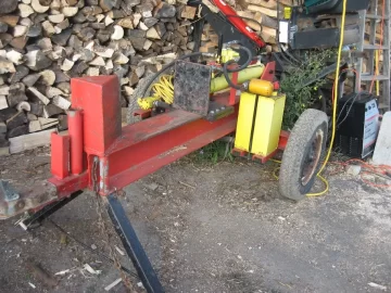

I run a 16 gpm pump and 4.5 inch cylinder with a 5 hp electric. Works great and all of my scrounged rounds get dumped easily within 50 ft of my shed anyway.
