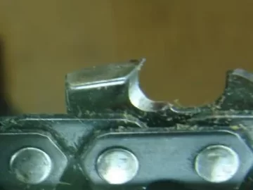

That wheel alone is 250.00 bucks. Really just kinda got to watch the spark count. She is only shinning that gullet. Takes 3-4 taps and pursure is every thing. Sparks dont lye.
Another one me one the 511a
[youtube]http://youtu.be/Ejqffmg-gWE[/youtube]
Does sound MEAN Though! It is the best set-up I have used.
This pic still has one tap to go. Takes very little off.
